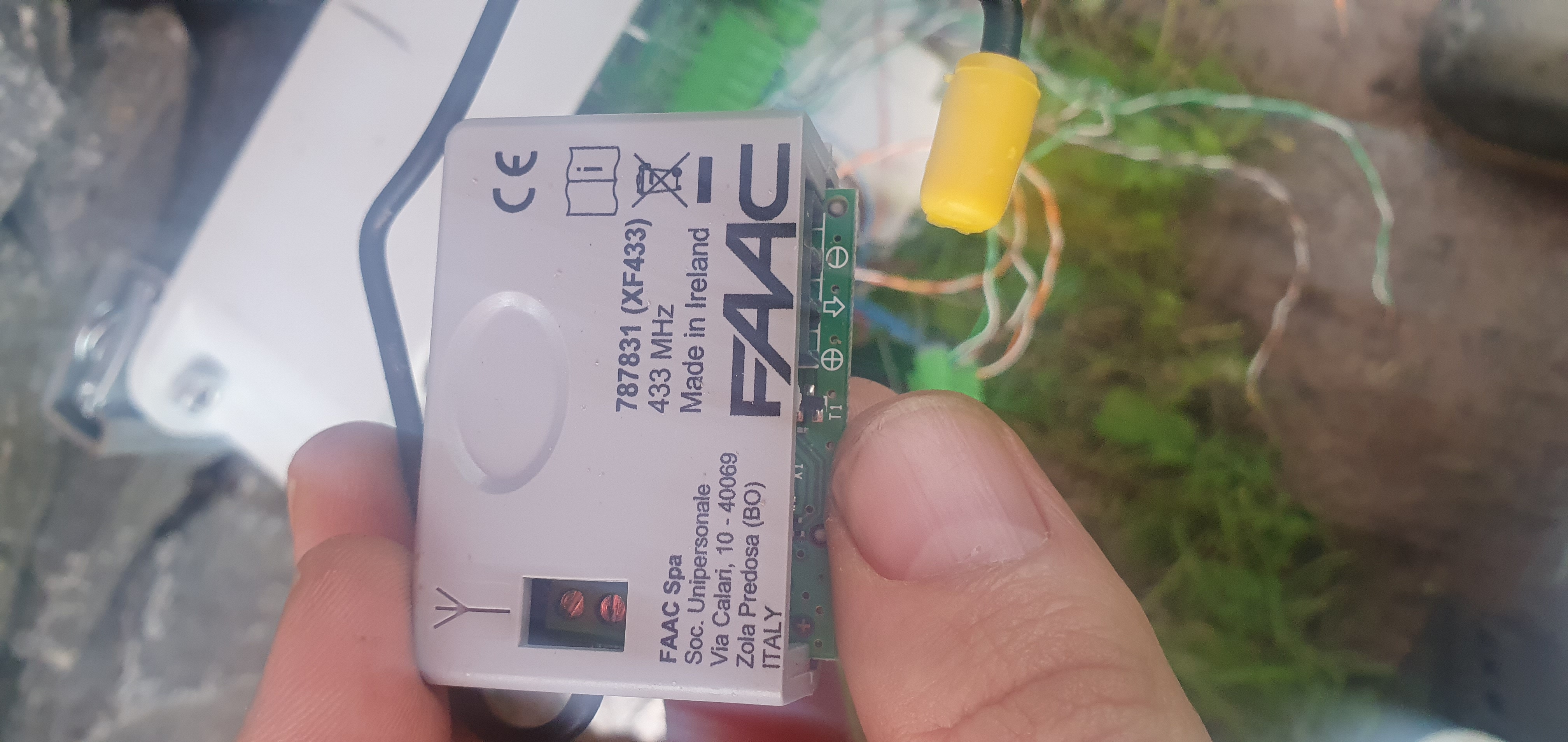

Hi I am installing an xf868 receiver to my 455d control panel but I am wondering is this quick connect as cables come loose when I connect up to power supply manually when pushed in. The receiver is 3 connectors but panel at quick connect is 5, ant help here would be great.
(29-10-2021, 02:20 PM)Dec Wrote: Hi I am installing an xf868 receiver to my 455d control panel but I am wondering is this quick connect as cables come loose when I connect up to power supply manually when pushed in. The receiver is 3 connectors but panel at quick connect is 5, ant help here would be great.
Hi I contacted the seller and I have been informed I got the wrong part by mistake so awaiting replacement. Hopefully this resolves the issue.
(30-10-2021, 07:50 PM)Decyep wrong type, need the other plug on board, that is is used on 24v boards Wrote:
Hi Dec,
Power will be wired into the receiver. You will then need to wire from the relay outputs to the push button/open input on the 455d panel. When the receiver is triggered, it will trigger the input, opening the gates.
-Jamie
