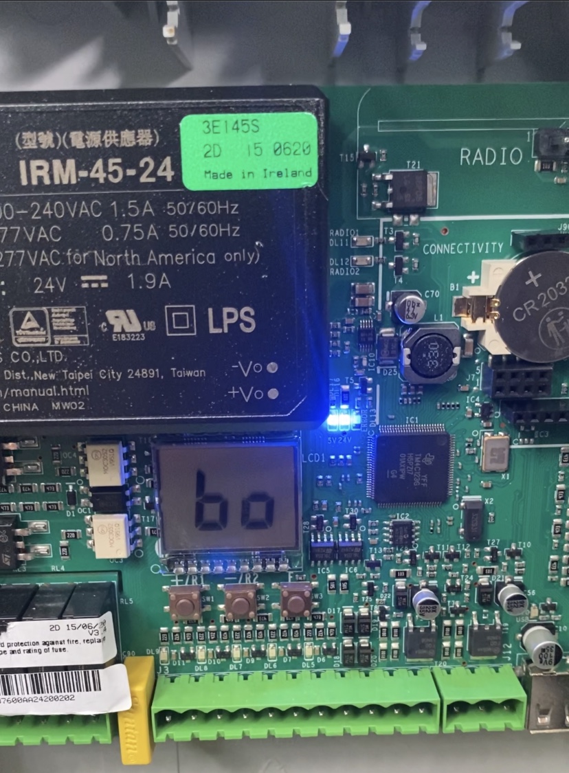

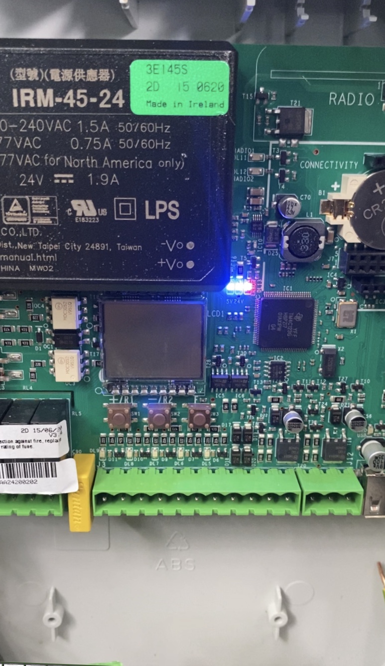

Hello,
When I power up my cb the display shows the following:
"bo" with two blue led's for 5 seconds.
It then changes to blank screen with two blue led's and one red.
Nothing else appears at all.
Can anyone advise on this? Is it possible to do a reset?
Could the board not have any software on it and do you know if it's possible to have faac look at this? It's a new system which I have just installed and can't figure it out.
Thank you for your help.

I have exactly the same problem. Got the board replaced but it’s doing exactly the same thing. bo and 2 blues and red error light.
Did you get a solution?
There must be a way to reset the software?

you need to wire the connectors first, it cant see any safetys etc.
then you can go through programming using the 'f' key
