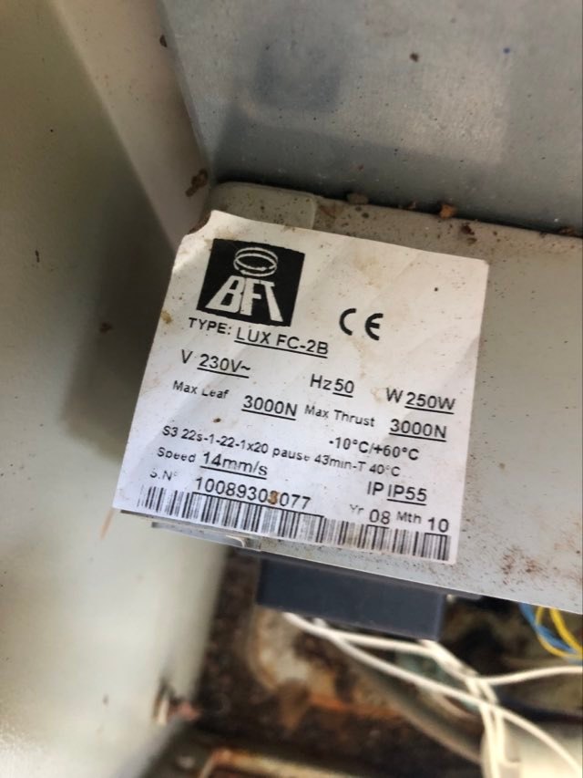

Hello I have the Lux fc 2B I tried to upload some pic
I think I need to change the running time but can’t find a manual to show me how
I will try send pics Monday when I get home.
(12-08-2022, 04:04 PM)jc.34@outlook.com Wrote: Hello I have the Lux fc 2B I tried to upload some pic
