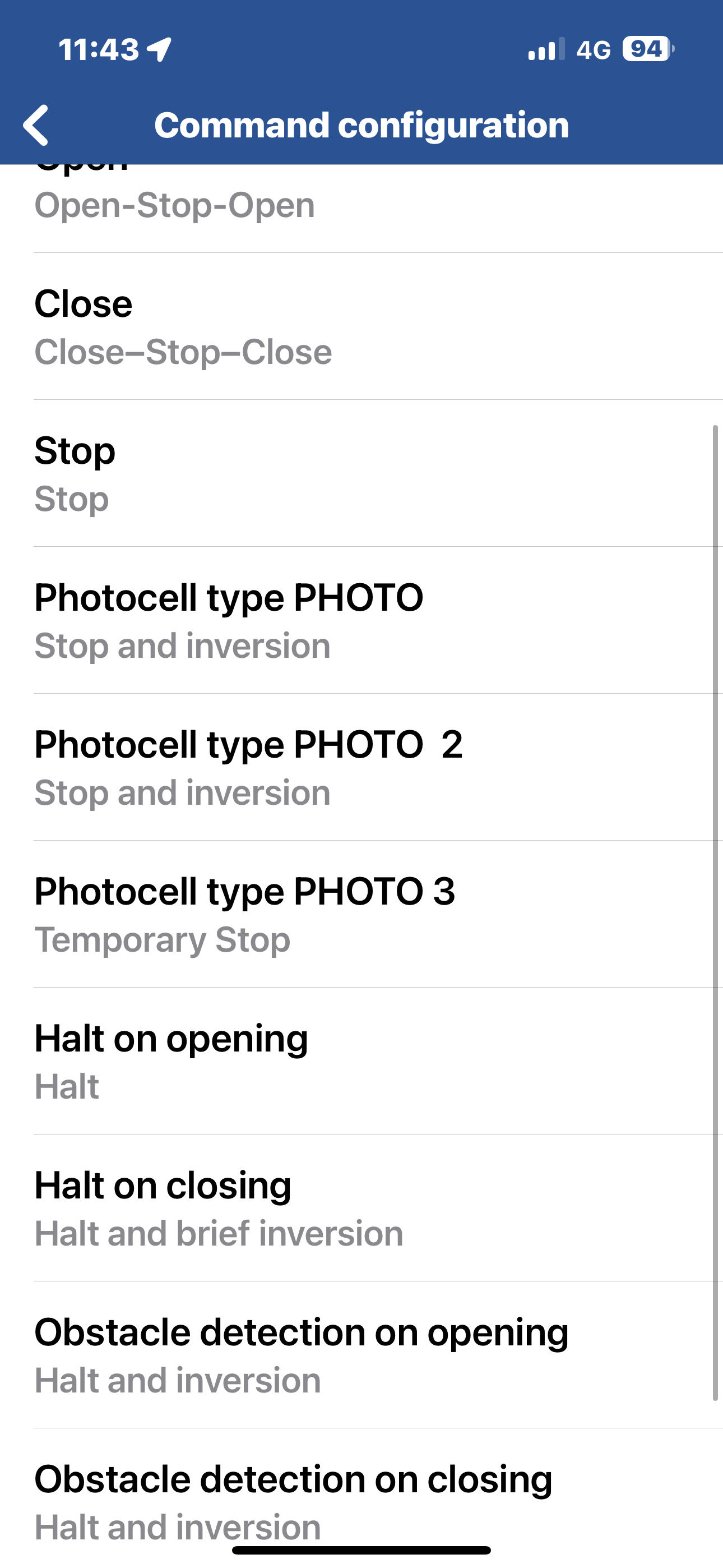

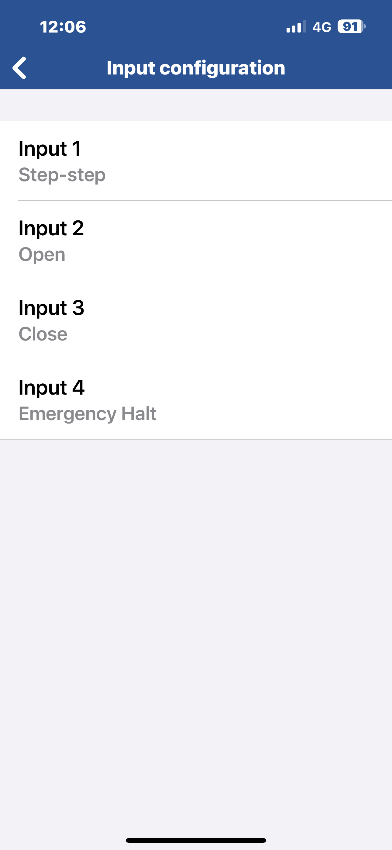

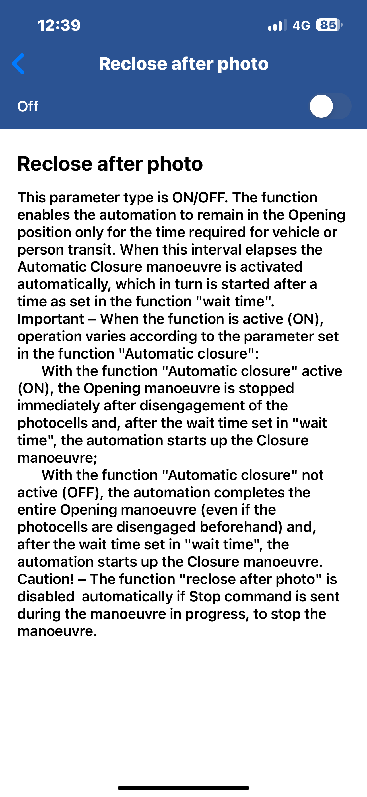

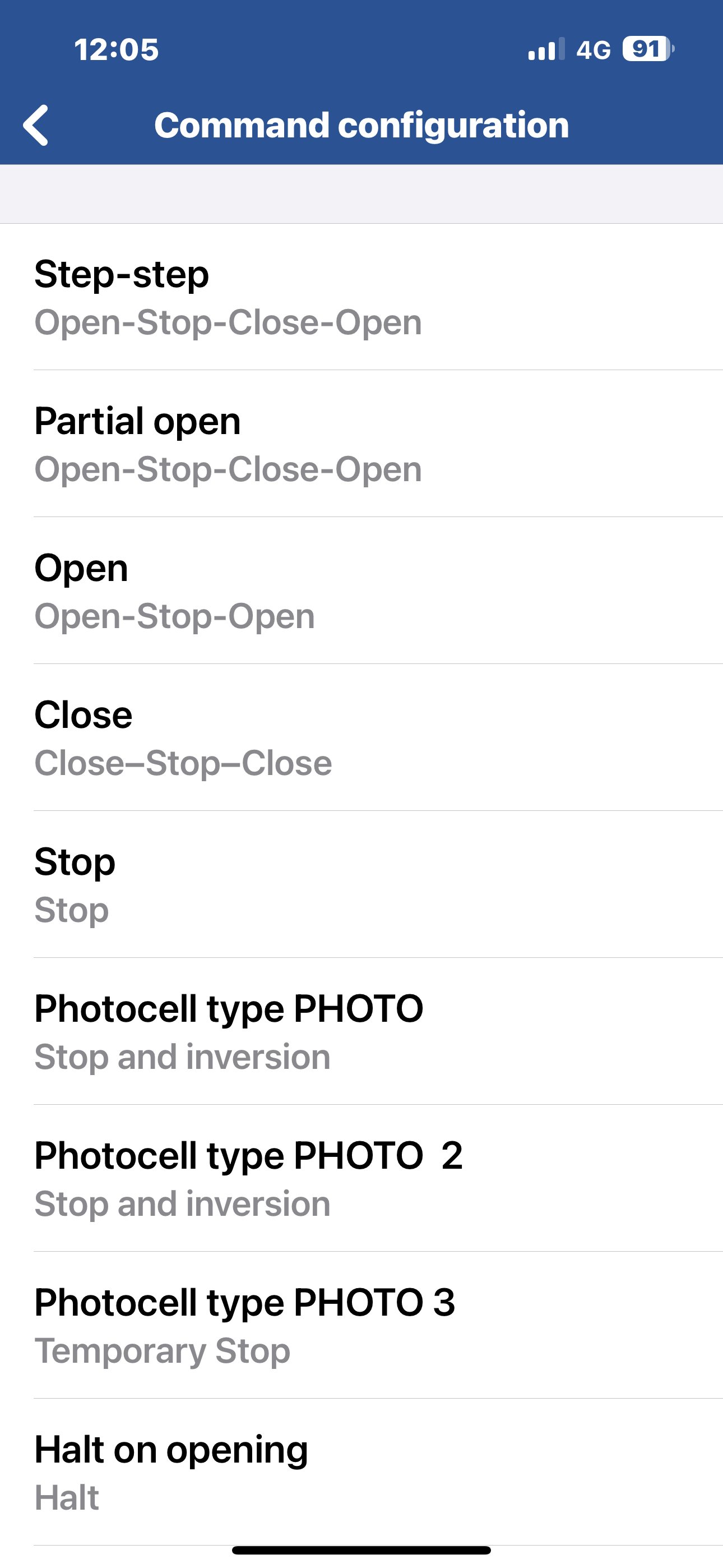

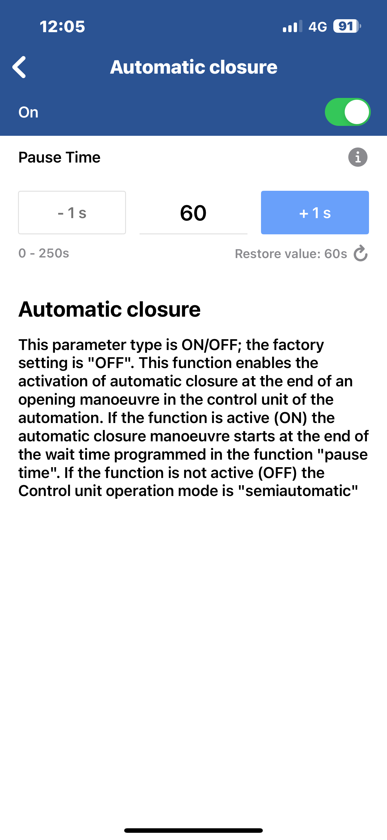

I have a Robus RB600 gate and have 2 issues I'd need help with.
1. The automatic close is enabled, however it only works if nothing passes through the gate during that time. If a car or a person breaks the the photo beam during this time, it will not auto close anymore...
2. During the opening, if a car passes before the gate is fully opened, the door halts at that point, and will not continue to open as it should. tried various settings w/o any success.
I would really appreciate any help with this.
Many thanks in advance!

The board is receiving a second command. If you could call through to the number below, we can assist you on this.

Thanks, appreciate the offer. I was hoping to get the info (which seems to be trivial to an experienced gate installer) here, w/o paying for it, that is why I posted the screenshots of my configuration...
