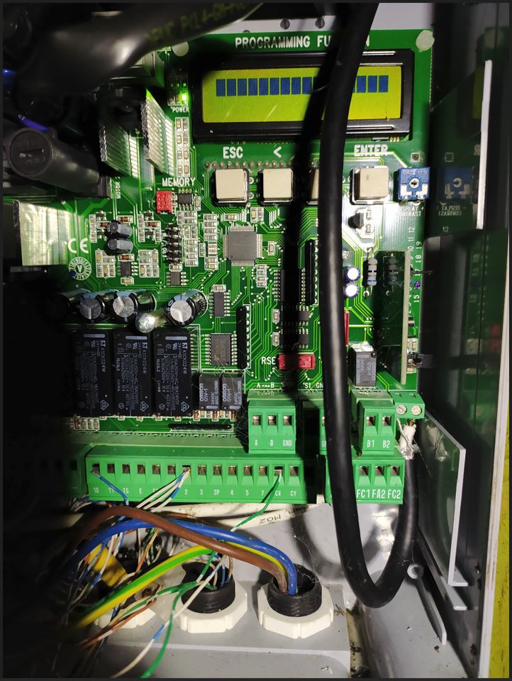

When I opened the control panel box to see if I could program of reset the gates I noticed some water in the bottom of the box, it has been raining a lot here for the last few weeks. The programming display is only showing solid bars, and the four buttons below did nothing to change this.
The PCB and transformers appear dry from the front and there is power to the board, however my instinct is leaning towards the PCB being damaged and needing replaced.

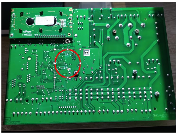

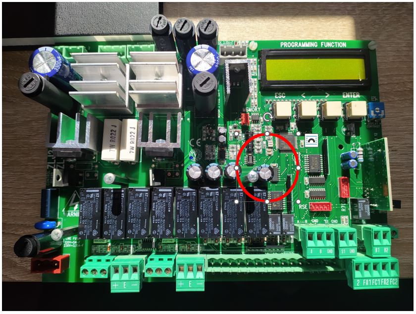

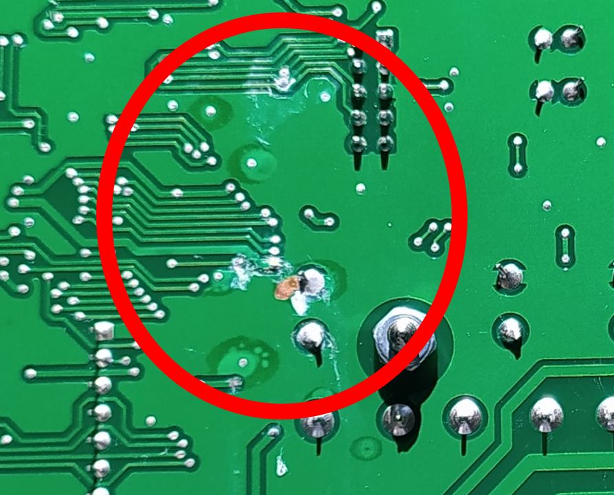

Thank you for the offer. I pulled the board out yesterday and found the culprit. A slug had decided to turn itself into a new track, shorting one of the smaller capacitors against an IC chip (to my eyes anyway). Maybe a couple of resistors higher up on the PCB too.
I removed our sadly deceased friend, cleaned the contacts, and refitted to PCB, but the state remained the same.
I'm going to buy a replacement board and an adhesive seal for the control panel box to prevent any more unwanted guests. I'll post an update here once this is done.
