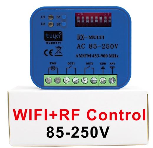

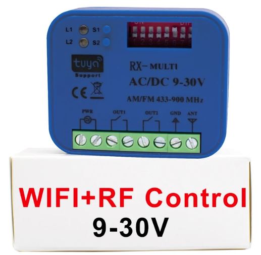

I'm new here, and need help with buying and wiring.
I have a gate with a BD400 motor that works with original remotes.
I would like to add the ability to open it from the smartphone.
I was offered the item in the picture
1. Does it fit
2. Which voltage to choose
3. If it fits, how to connect it (which wire to where)
4. If not, I would be happy to receive recommendations.
Thank you
I am afraid I can not offer any advice on this unfortunately on this occasion as it is not a product that we supply, however I wish you the best of luck.
However, if I had to guess you would have to find a sufficient powersupply for your PWR terminals, then from Out 1 you would take the two cables into your open command or your SBS command.
