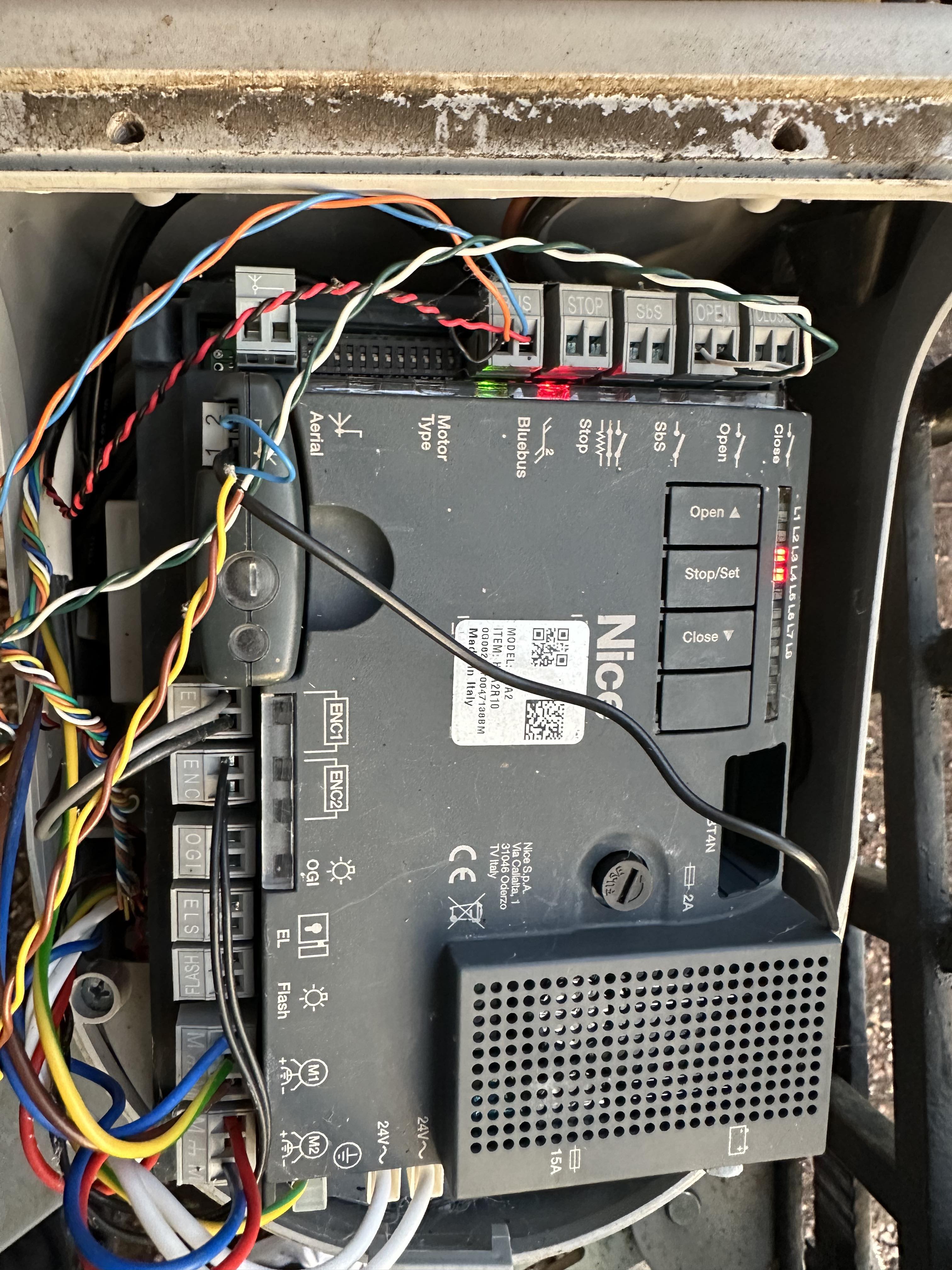

Hi guys, i looked for ansver in all over net but cant find a thing :/
My robus 600 is stop working 3 days ago, when i opened the top i saw on motherboard L1 and L8 flashing constantly.
Bluebus not flashing just nothing not a light on it.
I tryed to reset but nothing happened. Pressed OPEN and STOP/SET buttons for 3-5 secs many times but L1 and L8 continues flashin not L1 and L2 or any else. Cut out power many times but nothin.
Checked all fuses, nothing.
Called a guy in service, he told me maybe there is a problem on pohotocells.
I looked about L1 and L8 same time flashing trouble but cant find anything, any ideas????
