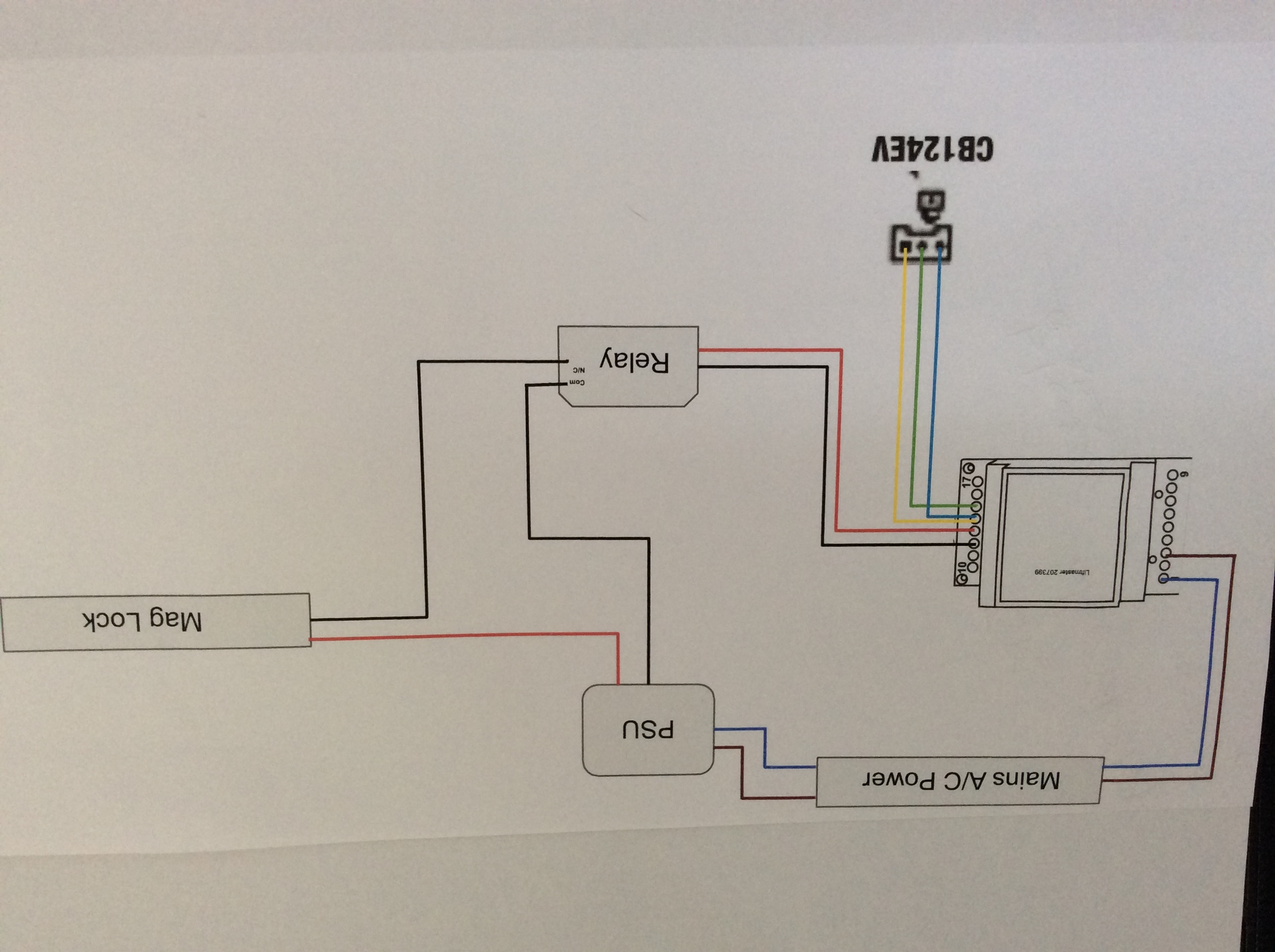

Does anyone have a diagram for fitting a mag lock on a CB124EV control card.
I have a Liftmaster Interface,Psu,Relay and Mag lock. Thanks

Attached is a diagram I have put together showing a mag lock  working off a CB124EV control card.
#9
(06-07-2022, 11:01 AM)Defender Wrote: Attached is a diagram I have put together showing a mag lock  working off a CB124EV control card.
That's a great diagram. We will use that in the future.
