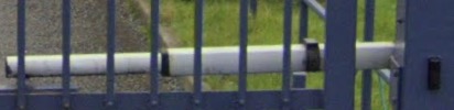

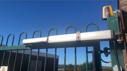

    • As you can see in the photo, they have a distinctive three-section design. The main body, a central black cap/ring (which hides the manual release allen key port), and then the rear mounting section. This black cap acts as a clear visual separator between the two larger sections.
    • While they resemble BFT Lux models, the specific appearance of the "grey parts" and the distinct sectional design doesn't perfectly match all current Lux images I've found online, leading me to believe they might be an older generation. I'm wondering if they could be an older BFT Lux FC model specifically.
  • Manual Release Confirmation: I've personally seen maintenance staff access that central black cap to use an allen key. They did this when one of the gates was ajar (open a tad) to put it into manual release mode, allowing them to move it by hand and then "reset" the system. This confirms the presence of a manual release and likely a hydraulic lock.
Photo: The exact same “mystery model” I found at a tram depot on google maps, so here’s a image:

Really need a better picture of the ram.
Reverse movement is classed as reverse stroke to release electric locks or sprung drop bolts before opening gates, totally normal but not always needed.
General service agreement/contract should already be active if youe school is using the gates. BFT brackets tend to bend on the leaf reducing their final travel to the maglock, these will require replacing. Sounds like the stroke geometry has not been correctly adhered too.
BFT Lux's are a standard model and haven't really changed, the 230v motor relies on a 6.3uf capacitor to offset the phase and drive the motor clockwise or anticlockwise depending on which winding is energised. They do not have a slowdown phase but a hydraulic restictor valve setup. You can use the slowdown parameter on different boards i.e. FAAC 455, SEA Gate2/swing etc... BFT Rigel 4/5 or 6 specifically state not to use the slowdown parameter for hydraulic motors due to the stall effect.
Hope this helps
Darren
(08-07-2025, 09:54 AM)old guy Wrote: Really need a better picture of the ram.
Hope this helps

Regarding the picture of the ram, I understand. As mentioned, my access is limited to publicly available Street View, but I've tried to provide the best close-up I could get from that source (the image you'll see titled "image_5225e5.png"). If there are any other specific angles or aspects you think might still be discernible from such images, please let me know.

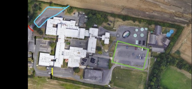

To better understand the layout of the school and the gate locations, please refer to the site diagram below. Following that, I've included multiple photos of the identical North End gates. Please note, these photos are taken from publicly available Street View, which explains any blurriness or limited angles, as I do not have permission to photograph the problematic South End gates directly. However, the motor design is exactly the same on both pairs.
Diagram Key:
  • Green Box: Carpark 1 (protected by South End Gates)
  • Blue Box: Carpark 3 (protected by North End Gates)
  • Red Line: North End Gates
  • Yellow Line: South End Gates

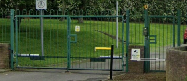

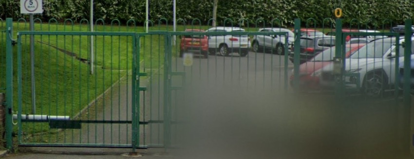

  • North End Gates (wider view from public side), showing a pedestrian gate to the right.
  • North End Gates (slightly closer, blurry and glitchy view from public side).
  •     Close-up of one of the identical motors (from the North End gates).

  • Gate Purpose: The South End gates (Yellow line on diagram) protect a taxi drop-off and pick-up area and Staff Car Park 1 (Green box on diagram). The North End gates (Red line on diagram) protect Staff Car Park 3 (Blue box on diagram).
  • Magnetic Locks: Both the north and south end gates at the school have magnetic locks to secure them in the closed position.

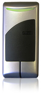

  • Impro Card Scanner: Access to both gate areas is managed by Impro card scanners, which are consistent with other access points around the school.

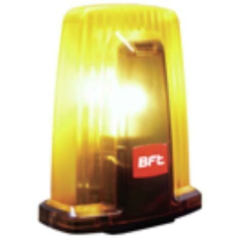

    • The BFT RADIUS flasher is now on all the time, even when the gates are completely closed and stationary. It has completely stopped flashing. This is definitively a controller issue, as when power is returned to the system, the light now turns on instantly, unlike the usual 1-second delay seen in normal operation.

  6. Regarding the BFT RADIUS R0 flasher being constantly on and having stopped flashing, now turning on instantly after power cycle (indicating a likely controller issue): What are the probable causes for this? Could it be a faulty relay on the control panel, a wiring issue, or something else entirely? (I assume the control panel is of the same brand as the motors, if that helps in diagnosis).

And here’s a photo of the BFT R0 flasher if it helps:

From the look of the photos, and the motors having three sections to the body, they could be a type of BFT Kustos although without a closer image I wouldn't be able to make a judgement on an exact model.
If the motor is not quite reaching the maglock then I would recommend increasing the force of the motor and then putting it through a position learn.
 The reversing before the opening command could be down to the "ram" function on BFT operators it is typically activated when a maglock or electric lock is in use so the gates do not jam on the lock, however this can be turned off.
I hope this is of some help, if you have any questions please let me know.

Photo:      You can see the BFT R0 flasher too, which is STILL not working properly.
