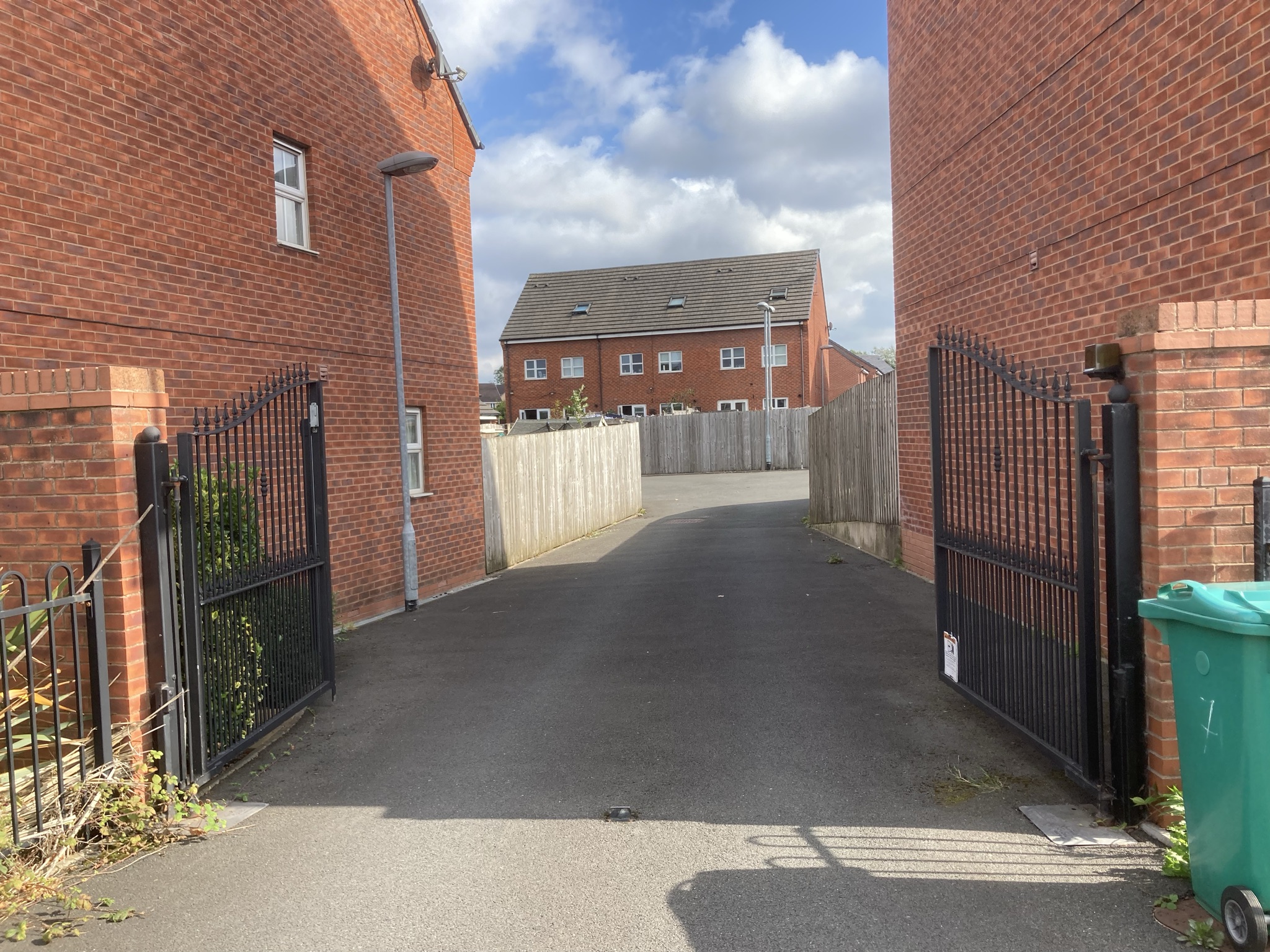

I am a property manager for CFH management in Bolton, I am starting to manage properties with Electric gates and I am on a steep learning curve as to the current legislation, One property has two Ditec leaf gates, recently refurbished, but from Jan 1st I have a site in Manchester with ten sets of GBD (Gibidi) leaf gates, which have been isolated for none compliance by the service company. From my experience with gate service companies they seem hell bent on isolating gates if they are Non compliant which seems to be the practice across the board, (They wont take them on service contract unless compliant) If a gate is found to be 13 years old and deemed none compliant, this gate would be non compliant to todays standard, but would have been compliant when installed and been CE marked, it does not suddenly become unsafe when regulation change. Where the gate is found to be none compliant then that should be reported as "requires improvement" but the gate left working, any improvements are for the gate owner to consider and It is the owners responsibility to take the risk. A gate should only be isolated where a safety critical issue or device is defective or become structurally unsafe, only then does the maintenance contractor have the authority to isolate the gate, lock it off and leave it in a safe condition.
The owner of these gates has now been quoted £26K to return them to service, my question is, after spending £26k today and the legislation changes tomorrow should the gates be isolated again until compliant?
