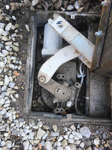

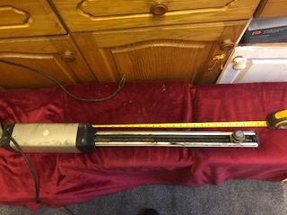

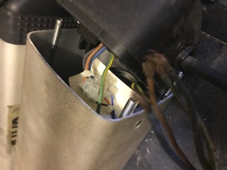

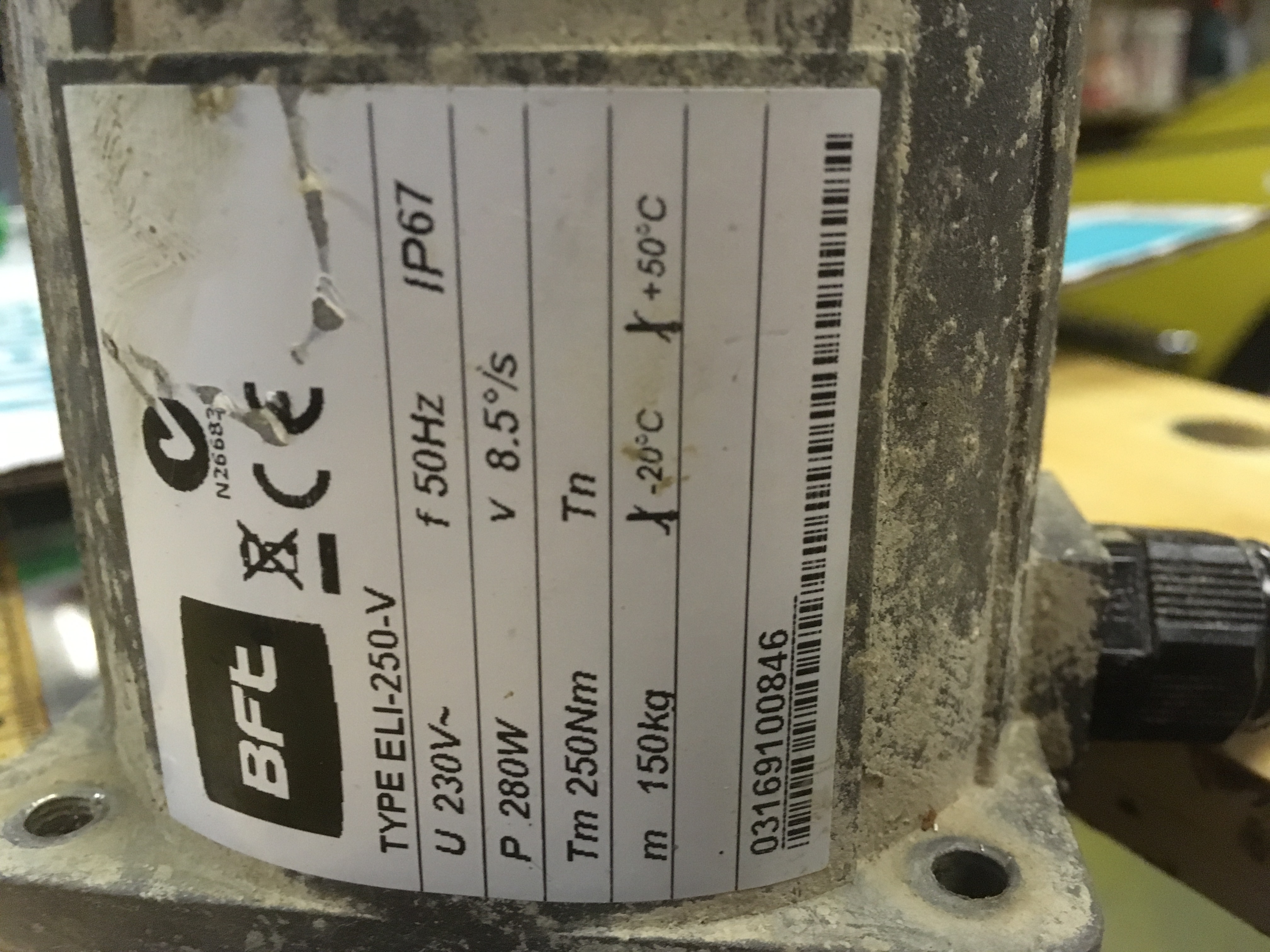

[attachment=280     Hi I hope these help mine are 230v
Thanks for the reply George. Unfortunately not the same. I should of mentioned mine are for swinging gates not sliding.
Hopefully I have now attached some pictures
I thought I would update the post just on the off chance someone in the future had the same problem.
After some tests and endless internet searching I now know.
1. These are BFT Phobos motors pre face lift model
2. They are powered via 230v

4. Motor Wiring as follows
Blue - Neutral
Black - Close gates
Brown - Open gates
Green/yellow - Earth
