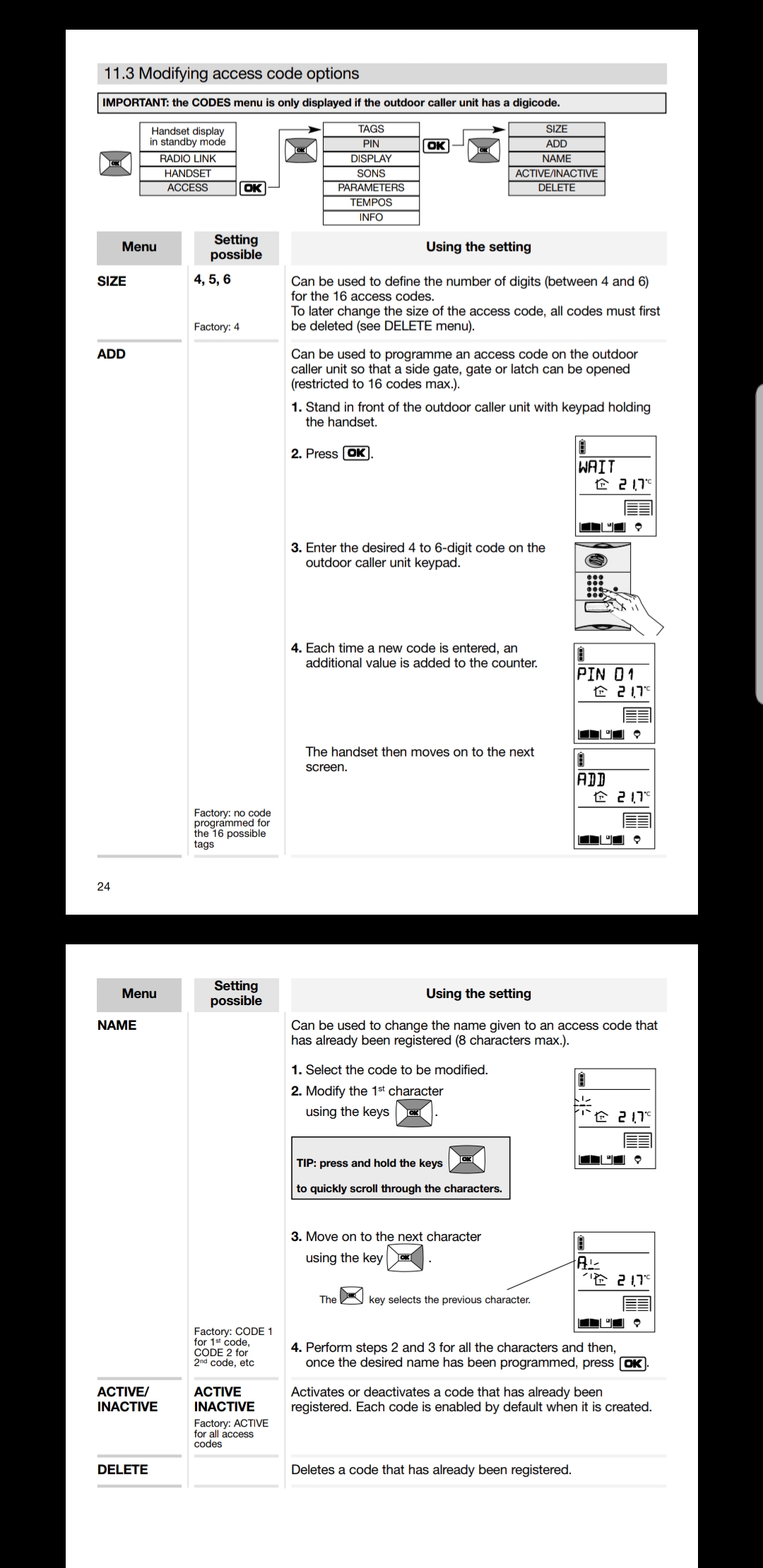

I did find a guide on the web for the Daitem Wireless Intercom but the path to follow on the guide is not changing the code when I enter it?!. I'm at my wits end as I have 2 small children who have found out the code and I live near a very busy A road. So I urgently need to change the code
The system set up I have is CAME gate mechanisms on heavy iron gates, a Rosslare on the inside and the Daitem intercom on the outside of the gates , I think it is the SC902AU , but when I read the installation guide on the web it is only for the door phone.

    Using your intercom handset open the flap and scroll through the menu to delete the old code. Then scroll through again to add a code.
Stand next to the gate with your handset and when you press ok on add code it says wait.
Add the new code and done.
The manual showing how to do it all from the gate didn't work but using the handset method stood at the gate was easy.
