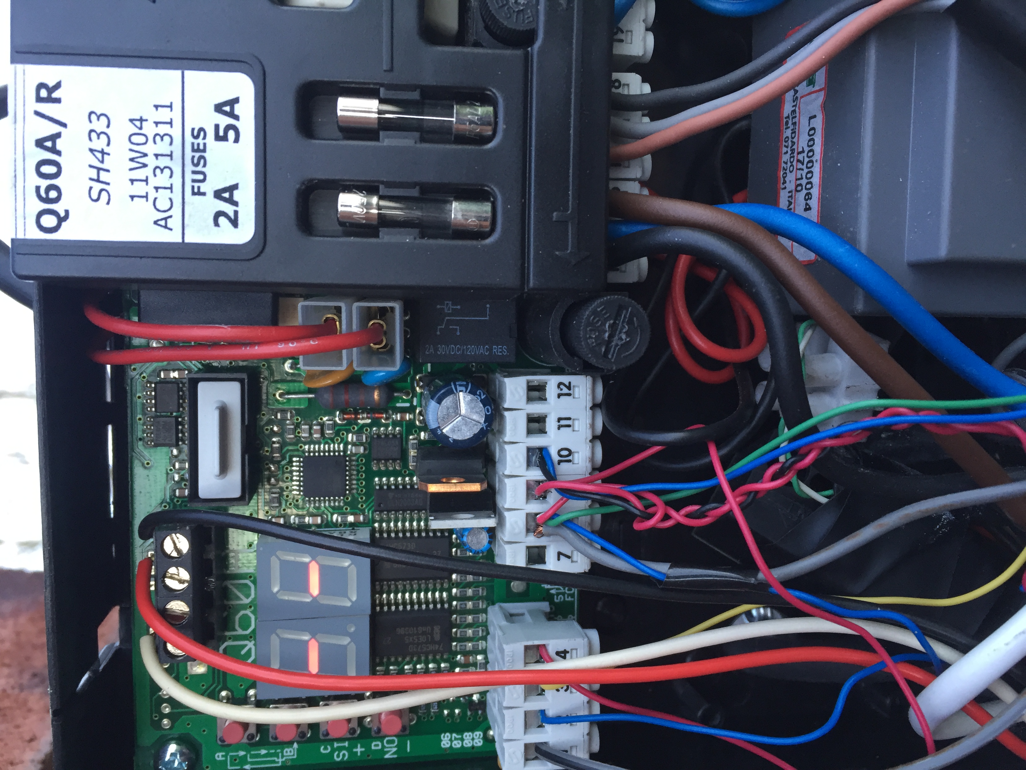

Hi my gates stopped opening. Error code is n1 motor problem (Q60A/R)control unit.checked fuses and capacitor where can I look from here.thanks in advance

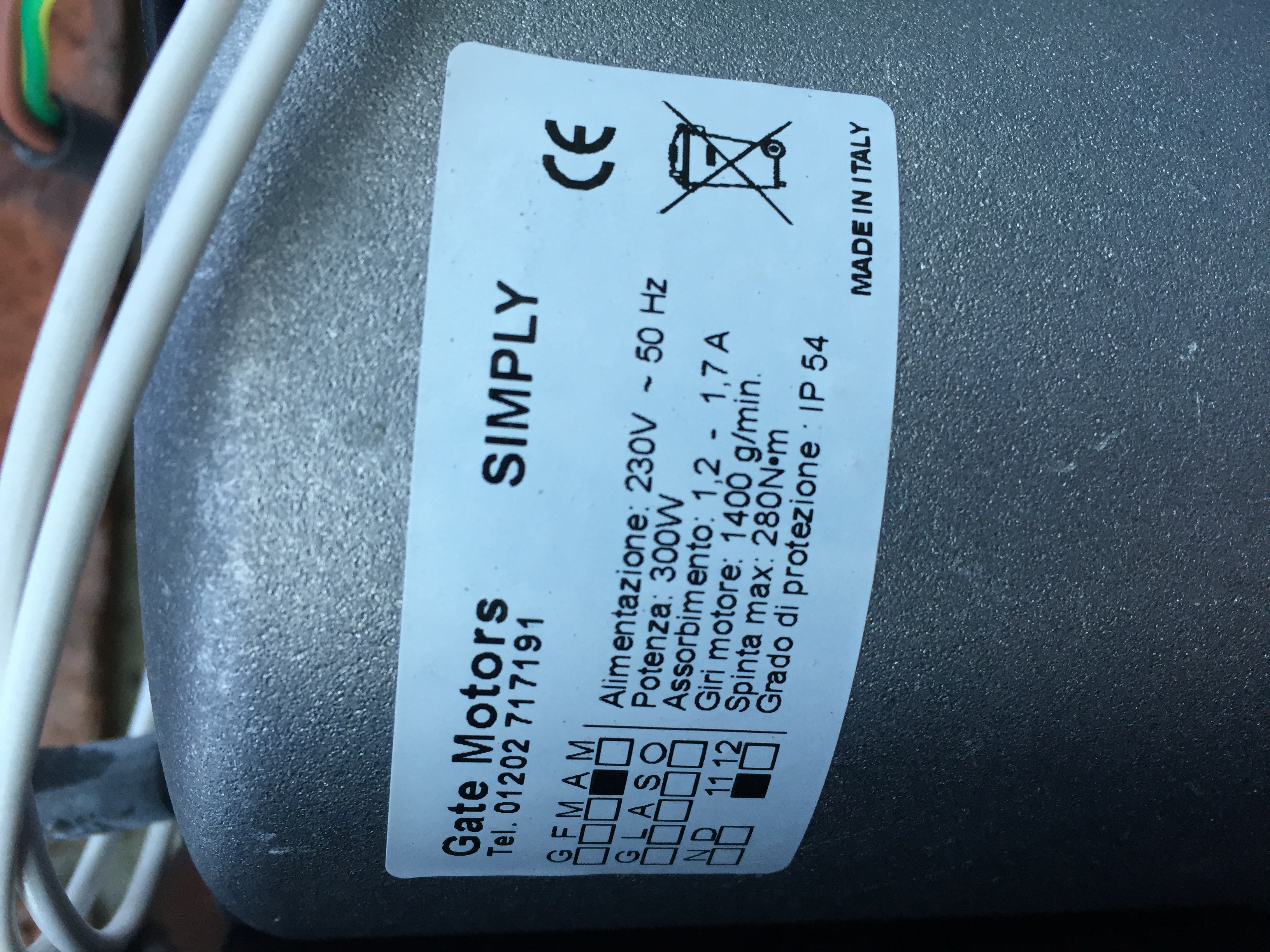

(12-01-2017, 06:02 PM)Johnmc Wrote: hi bypassed main board and powered up no movement from motor . Am I looking at replacing the motor. hi have you got some motor picture , label with tech data regards Best Regards
