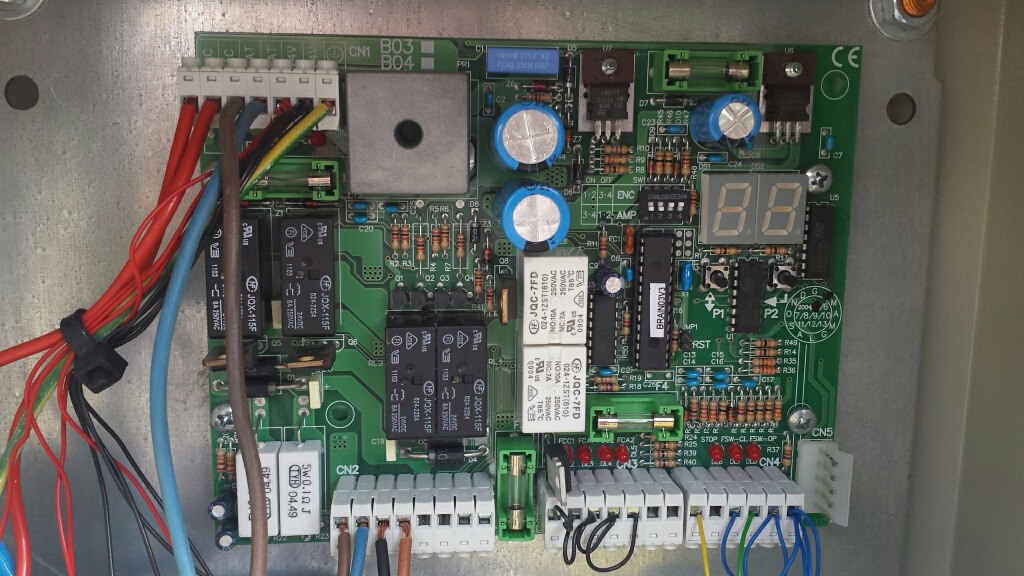

Hello Everyone,
I have just joined the forum so a Newbie Smile
After reading previous threads I haven't found the same problem so I am hoping you can ALL help. Thanks in Advance.
Situation:
We moved to a place with electric gates approx. 18 months ago.. Nice to have and feels secure.
I have recently come across my first problem which seemed to happen around the time of heavy rain a few weeks ago (unsure if there is any connection):
My Gates are staying constantly open displaying "tc" on the control board.
Before the problem occurred, when you walked up to the gate between 7am to 8pm (these are the timer settings) they would open and close automatically when you walked/drove passed the sensors. However, the gates now remain completely open during these hours.

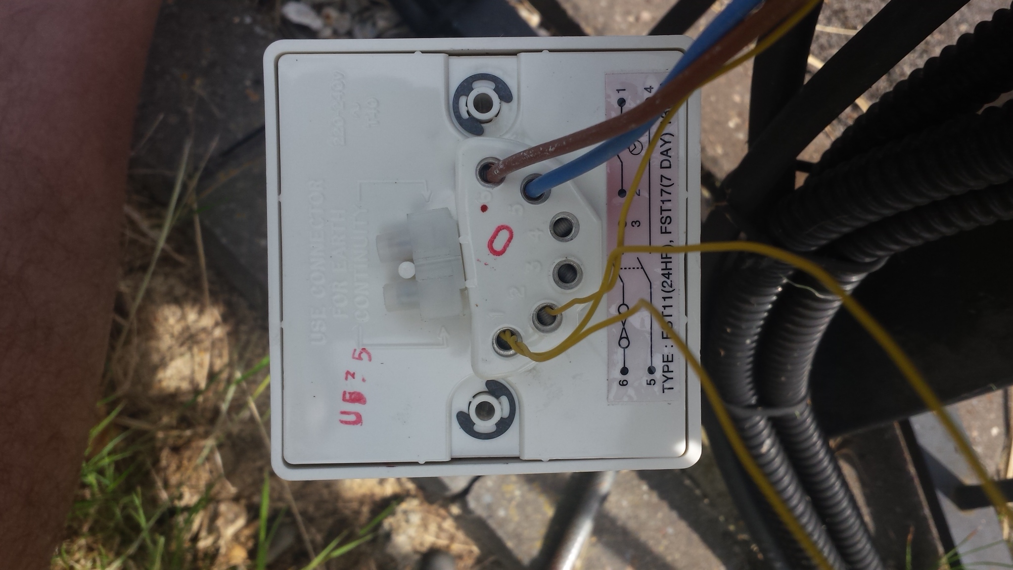

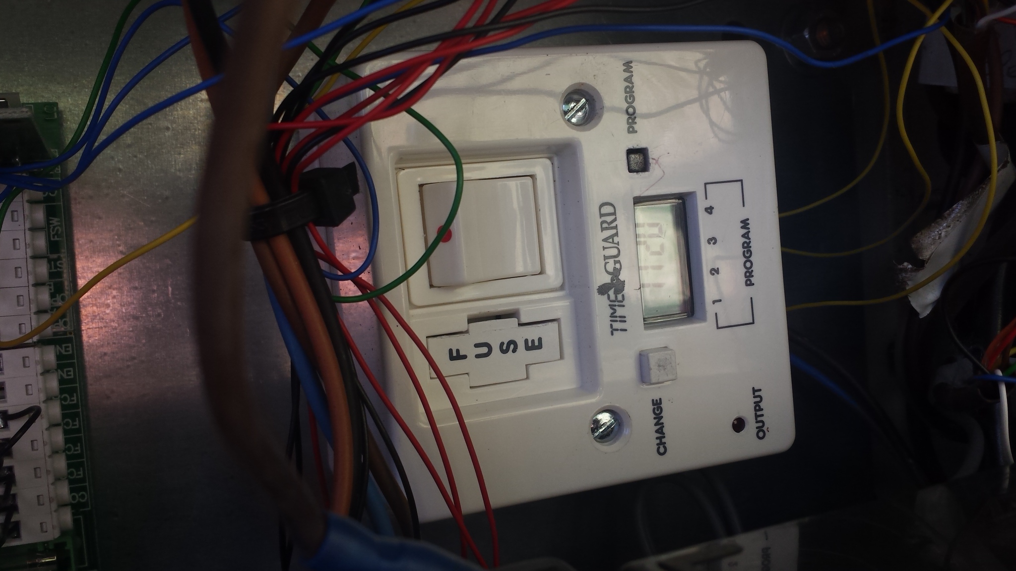

However, if I turn the timer off (Timeguard FST11(24HR,
FST17 (7DAY) the gates close and they can only be opened using the remote fob. Or if I disconnect the wire from the timeguard to the control board the gates close.
During the night, the timeguard switches to "off", and the gates remain closed until timeguard switches to "on".
I have taken photos of the Genius Brain 03 and Timegaurd unit if that helps.

Genius Gates
Hi ALL,
After some further investigation it has been narrowed down to the outside "Infra Red Photocell".
Currently its a SWG-0142 photocell no longer available
Can anyone recommend a replacement..
Many Thanks
AL
Hi Al,
It sounds to me that the timers output may be wired in series to any of the other connected devices which when switched off, won't allow for a full circuit to be made, hence why there would only be function from remote's rather than anything hard wired.
As for the photocells, this board uses pretty generic relay cells which can be purchased at the following address. If you need any more info, please let us know!
