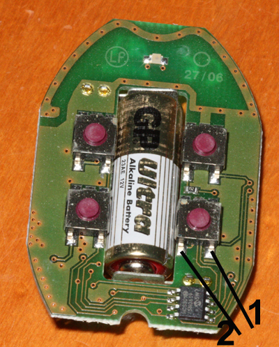

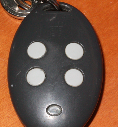

I have the MITO remote control with four buttons.
I want to connect it with a relay that is controlled from a microcontroller (arduino) All I want is to imitate the button press with a rellay
is the pins 1 and 2 (in the image) the only ones that I should use?
Thank you
Yes. I used to solder wires to those pins and fit Tx inside the RTE button in some strange applications Wink
www.webseb.co.uk
!!! Gate and Door Automation Engineers required (London, TW) !!!
sebabastek Wrote:Yes. I used to solder wires to those pins and fit Tx inside the RTE button in some strange applications Wink
A few hours ago, I risked to burn the remote. I short circuited these pins and the gate opened.
I am going to connect a relay wth thi and If I make it work, I will post some picturesif anyone in interested
Thank you for your response
It works perfectly. Arduino can control now the gate. It is funny.
