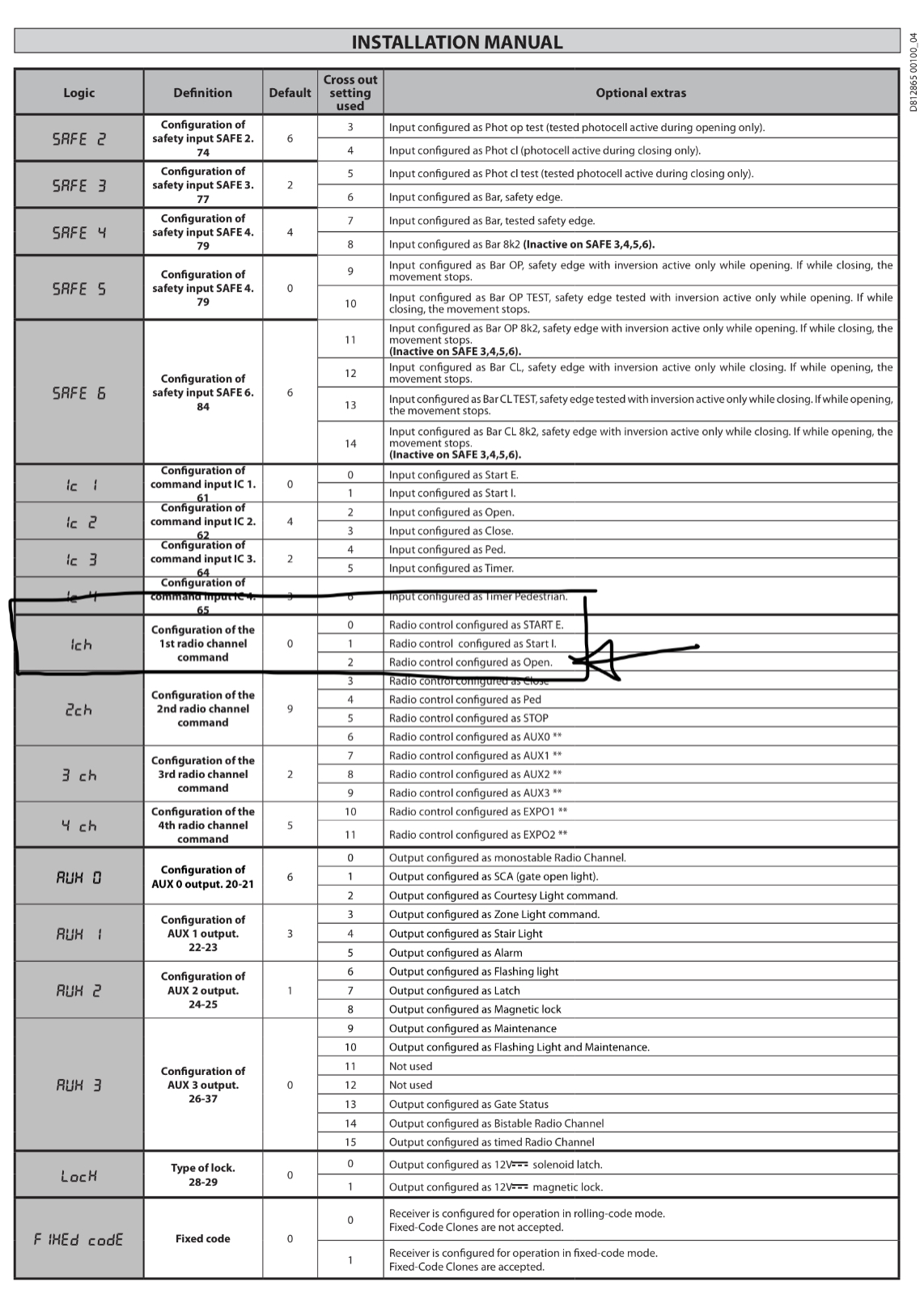

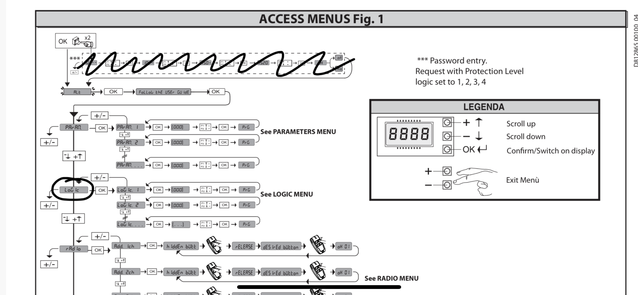

Sam’s method worked. Setting it to “open” still means the gates close after the Tca (automatic closing time).
All is covered on the manual. Extracts attached. I’ve scribbled out the password section as we don’t have one set (which is the default setting)
