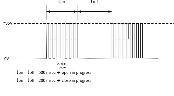

Hi Sam and thx for your reply
Yes you are right about the signal.
I put an oscilloscope to monitor OGI signal and it looks like in this picture.
Its a regular train of impulses when gate is moving.
When gate is steady:
 - if closed, the signal is 0V
 - if open (full or partially open), the signal is 20 KHz continuous
With some pretty complicated logic on my control device i can sense the state of the gate.
To get voltage-free signals I use optocouplers to sense OGI signal and to send commands to the gate.
Ves
