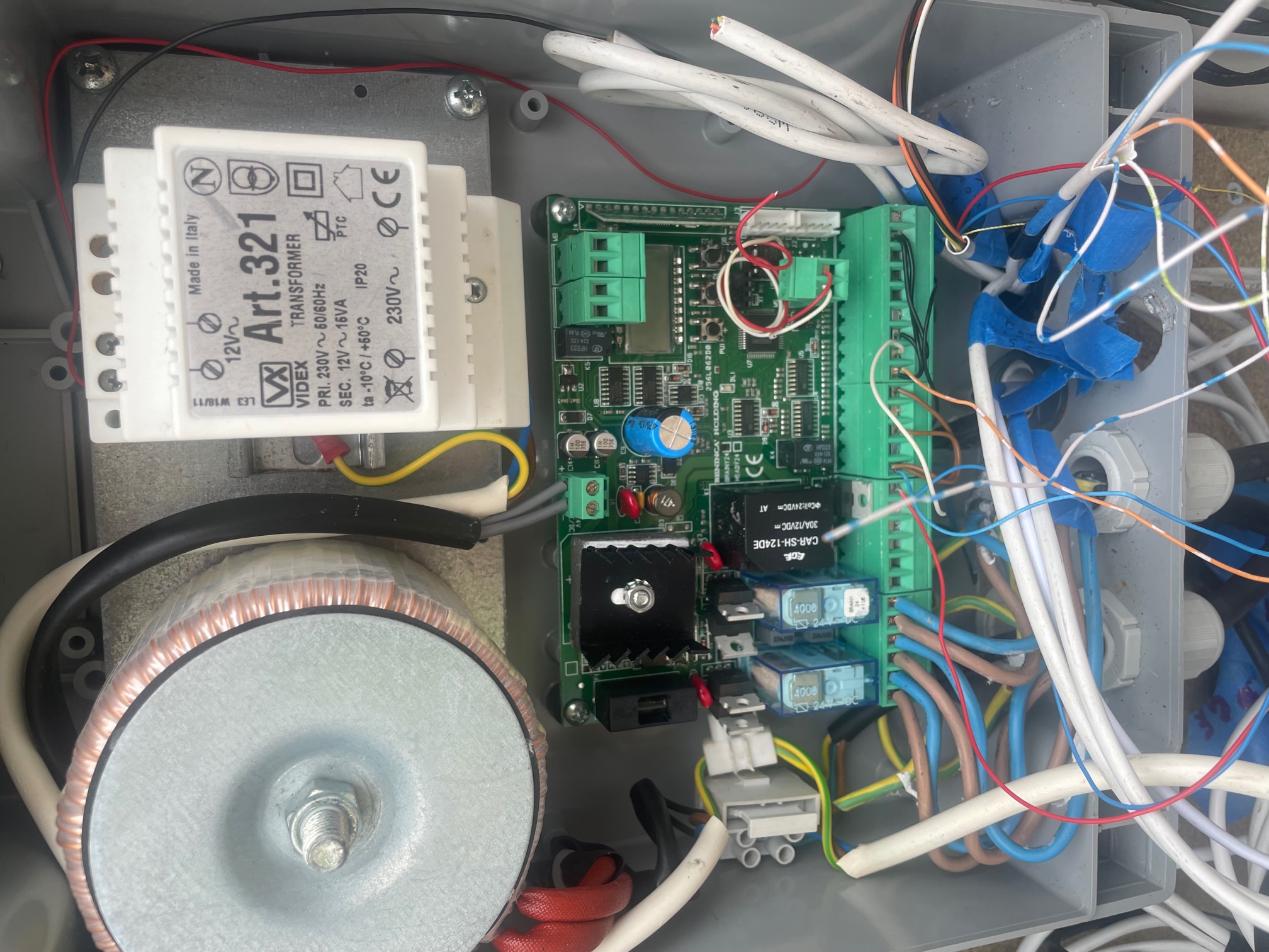

Hello i have a Beninca brain and beninca bob motors with outer and inner limits with com all wired up ready to go.  But during auto set up it displays the error 6 code which says safety edge has intervened but i do not have one installed when i run the motors off the battery they work fine but just manually with direct power feed to the motors are working but not from brain maybe i got it all wrong
is there a way to force the motors to work from the brain and anyone got the process from switching on to learning the brain how it all works
just lets say i just installed a new system what is the process to get the system up and running many thanks in advance

24 volt i have connected it up as per wiring diagram but does not do anything when switched on if i go to the auto it says the error
here is a picture of the board

Solved this one with a bit of help even though the edge protector is not fitted it needs looped out not only with a wire, but it must have a resistor in the wire to simulate a leading edge.  The solution i used was to connect a leading edge to the terminals and the system was happy and allowed test operation no fault present for leading edge hope this makes sense to all
