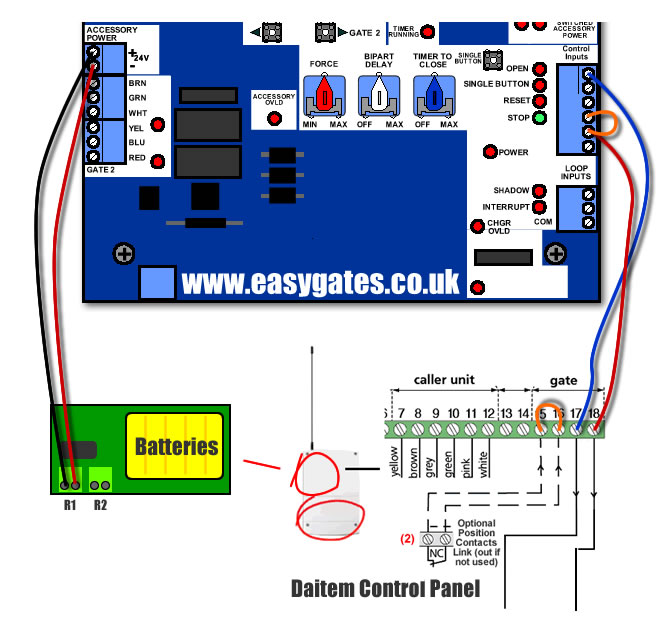

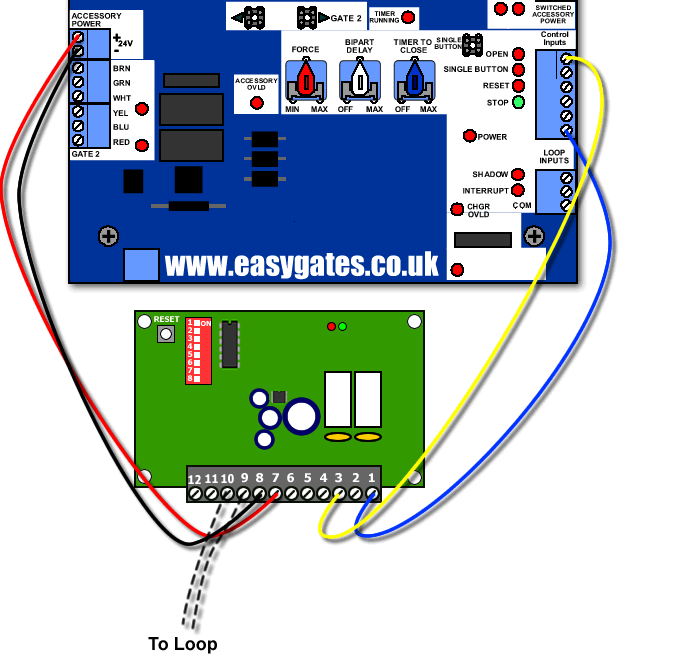

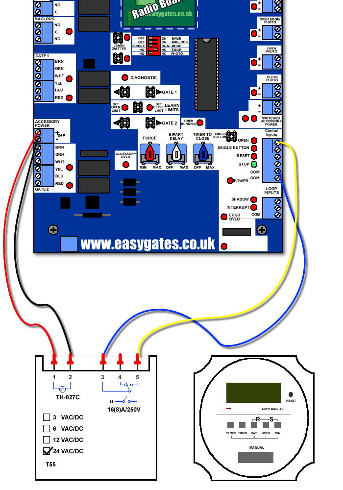

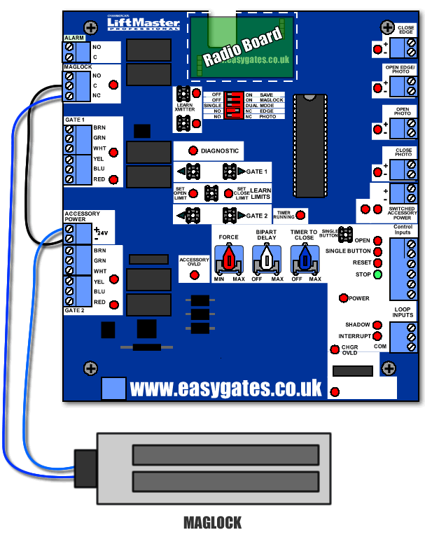

Heres some simplified diagrams on wiring accessories to the CB24 Control board.
1. Wiring a Maglock to the CB24V
2. Wiring a Daitem Intercom into the CB24
3. Wiring a 24V Time Clock into the CB24
4. Wiring a Loop Detector into the CB24
