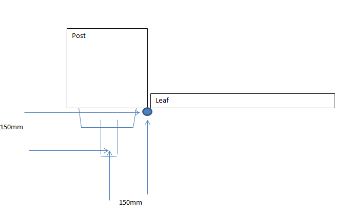

ok so can I just clarify with you.....
as long as A and B are a minimum of 150mm each from pivot it doesn't matter at what angle I mount the bracket together with regards to axis of rotation. I want it to be open between 90 and 110 degrees.
I have added a pic as well.
(10-01-2014, 09:10 AM)Suprabandit Wrote: ok so can I just clarify with you.....
Hi just to confirm i have attached our version of the geometry, note the measurements change for all types of different arms, but moovo is 150 x 150 please do not pay attention to the other measurements on this page as it is for a nice toona arm, hope this helps Smile

thank you so much! makes perfect sense now.
